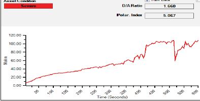

Figure 1 shows a 4160 volt motor at one of Energy Transfer's locations. The PI and PIP are shown. The windings are very contaminated with oil and dirt. This motor will be pulled and sent to a motor shop for reconditioning. If left in service, the motor would fail and cause interruption to the flow process of the natural gas.
Figure 1: 4160 volt motor showing both PI and PIP
