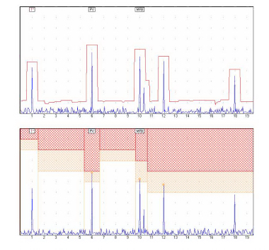

One of the biggest challenges was the task of setting alarm limits. How do you know how much vibration is OK? And who has time to set up all of the alarms anyway? With so many machines being tested, multiplied by the number of test points and axes, there were a very large number of alarm limits to set up - particularly if you were using band alarms.
So I tried to automate the process.
Upper and lower limitsUpper and lower limits
I allowed the user to specify upper and lower limits, and "deltas" of change allowed (for example, they could collect the "reference" or "baseline" spectrum and then tell the software that the levels could only change by a certain amount from that baseline).
It was not all that successful. At the time I had my supporters, and it did save people a lot of time, but it was not as accurate as I would have liked.
