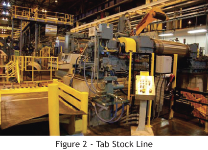

A new tab stock line was installed in the fall of 2007 (see Figure 2). The Level Clean Line is designed to a safety level that reaches Category 3, which is European Standard EN954-1.  Many US companies have adopted this standard in order to meet safety requirements.  The line is completely surrounded by fencing (see Figure 3) which meets ANSI standards for height, opening size, and distance from hazards.  There are a total of seventeen gate entrances around the line that are safety interlocked using Fortress Interlocks.  Each interlock requires that the operator press a button which acts as a request to enter.  Once pressed, the safety PLC will put everything into a safe state and then release the solenoid on the interlock allowing the gate to open.  Each gate is equipped with at least two safety keys which the person entering the gated area is required to take with them.  By having the key on their person, it keeps the machine in a safe state, prevents the line from running, and prevents personnel from being locked inside the area.
