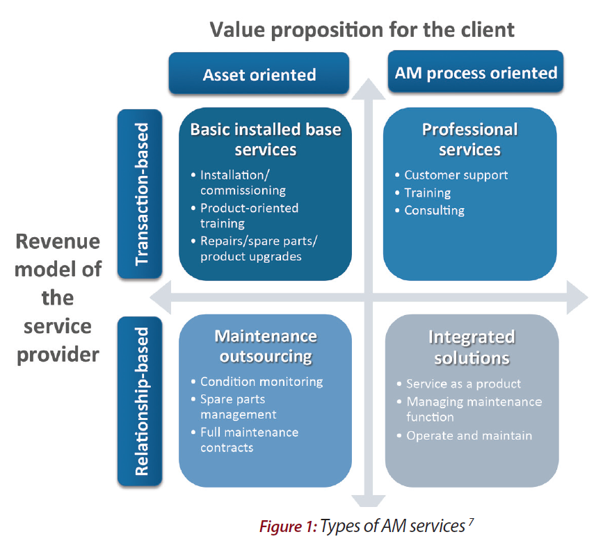

AM services can be classified according to the value proposition for the client and the revenue model of the service provider. Figure 1 illustrates four service classifications.
The most basic AM service is transactional and oriented at the asset itself. Such installed base services include installation, training in the use of the asset and the selling of spare parts.
The next type of AM service is also transactional, but oriented at the asset owner's AM processes. Client support, training and consulting form part of this service type.
Outsourcing services are relationship-based and oriented at the asset. The outsourcing of certain maintenance activities is an example of this type of service. The last type of service is integrated solutions. With these services, there is substantial value co-creation between asset owner and service provider. An example is an organization contracting out its entire maintenance function. Integrated solutions often involve performance contracting and gain sharing agreements.
