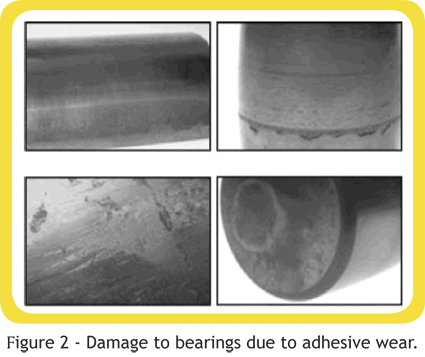

There are four basic types of wear: adhesive, abrasive, corrosive, and surface-fatigue.
The most common type, adhesive wear, arises from the strong adhesive forces that are generated at the interface of two solid materials. When solid surfaces are pressed together, intimate contact is made over a number of small patches or junctions. During sliding, these junctions continue to be made and broken, and, if a junction does not break along the original interface, a wear particle is formed. These particles eventually break away. Adhesive wear is undesirable for two reasons: first, the loss of material will eventually lead to deterioration in the performance of the mechanism; and second, the formation of large wear particles in closely fitted sliding members may cause the mechanism to seize at an early stage in its productive life. Adhesive wear is many times greater for un-lubricated than for effectively lubricated metal surfaces (Fig 2 and Fig 3).
