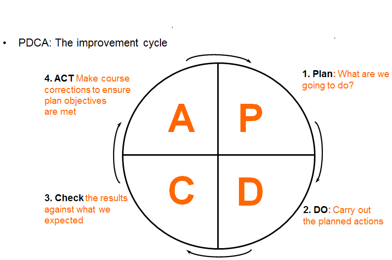

But a vision and mission, in and of themselves, do not produce results. Reliability initiatives, such as a pump asset management program, have a greater chance of success if they are strategically designed.Roquette utilized a plan-do-check-act (PDCA) action cycle to develop the scope and sequence of its program. Timing and sequence are critical; getting too many change initiatives started at the same time overwhelm personnel and rolling out actionable steps in the wrong sequence increases the likelihood the initiative will fail. The PDCA action cycle is shown in Figure 1.
Figure 1: The PDCA action cycle
It cannot be stressed enough the importance of the planning step in the PDCA action cycle. Several questions should be considered:
  1. Is the activity well-defined? What scope will be covered under the initiative?
  2. What resources will be required to ensure the initiative can be successfully completed? Are the resources committed to the assigned activities and do they have sufficient time to complete them?
  3. What is the anticipated payback for the initiative? Based on the required resources (e.g., time and money), will the payback meet company hurdles. Will competing initiatives produce a better return on investment?
  4. Is there buy-in from all stakeholders participating in or committing resources to the initiative?
  5. What needs to be done before rollout? Should the activity be rolled out in stages or all at once?
  6. How will success be measured?
