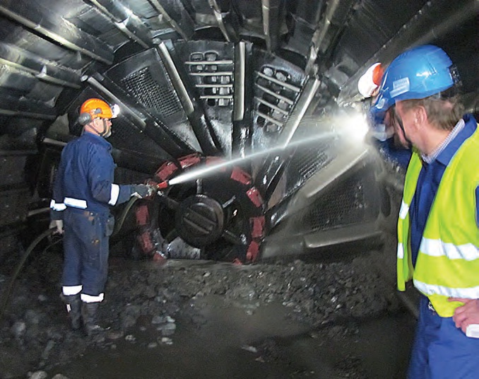

The main component of all mills is a horizontal rotating drum, typically with a rubber liner and regularly spaced lifter bars (see Figure 1). Generally, the ore is continuously fed into the drum in one end, then crushed and transported out in the other.
part2
Figure 1: The drum interior at Garpenberg during a service stop clearly shows the rubber lifters. The rubber lifters are clearly visible.
