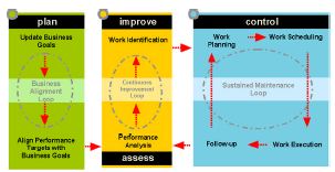

The Reliability Driven Maintenance Proces
To maximize asset reliability, and to reach their strategic objectives, Dofasco developed a four phase process:
dofasco_2sdofasco_2s
1) Planning. Dofasco matches their maintenance policies to their strategic business objectives. They identify their most critical equipment. The equipment they can't afford to have fail: the heart that keeps the company alive. Then they analyze how, when and why the equipment fails. (To continue the medical analogy, they understand all the things that can cause a heart attack: smoking, increased cholesterol levels, excessive weight, high stress, etc.)
2) Assess. Dofasco measures and monitors all variables that affect the reliability of critical assets. They produce trending graphs that warn of progressive asset failures. (Dofasco monitors the patient's weight, blood tests and stress level.) If all the readings are acceptable, no maintenance is performed. If an indicator exceeds acceptable limits, an alarm is triggered. Dofasco then performs corrective maintenance, which usually prevents catastrophic failure. (When the patient starts gaining weight, Dofasco puts him on a diet before his heart fails.)
3) Improvement. Dofasco analyzes asset performance, and the effectiveness of both the reliability driven maintenance process and the maintenance work. They continuously look for ways to improve. (Just like doctors who continually research the cause, prevention and treatment of heart attacks to ensure the best medical care.)
4) Control. Dofasco uses a Computerized Maintenance Management System, to efficiently plan, schedule and execute work. (To finish the medical analogy, the most important surgery is planned, scheduled and executed efficiently. Dofasco utilizes CMMS technology to ensure that all maintenance activities are conducted as efficiently as possible.)
