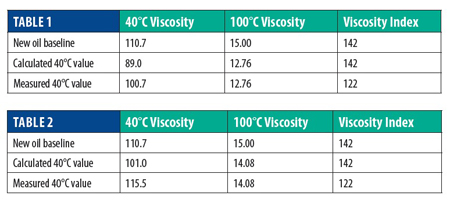

Let's examine two examples using the same measured 100°C viscosity, but one assuming VI is constant and calculating the 40°C viscosity, and the other with a measured 40°C viscosity.
The results in Table 1 suggest an approximate 1% fuel contamination in the calculated example, but none in the measured example. While the fuel level is not elevated enough to suggest an immediate corrective action or mechanical issue, it is misleading nonetheless. More importantly, the true measured value shows significant shearing, suggesting the need for an oil change and possible reduction in future drain intervals.
The results in Table 2 suggest a minor decrease in viscosity in the calculated example, but significant shearing in the measured example. The viscosity decrease in either example is not enough to suggest an immediate corrective action. However, due to masking by either soot contamination or oxidation, shearing is evident when the 40°C viscosity is measured and becomes obvious when the VI is included.
