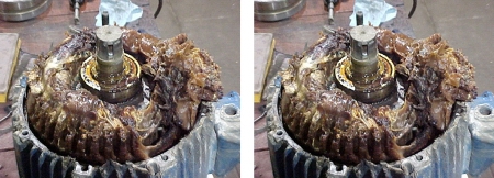

The biggest problem we find in bearings is the fact that they are over greased. The maintenance man doing the greasing usually does not know how much grease is put into the bearing. In the past we just pumped a few strokes into the bearing and then said well that ought to do it. Usually that was too much grease and the following pictures will show the results of that style of greasing.

In the case of this motor there was no attention paid to how much grease was being put into the bearing. The old days of grease until it oozes out are long gone but people do actually still grease that way. This motor actually had shielded bearings in it and there was no grease getting into the bearing, so it never cooled down and never got any quieter so they just continued to grease it. After a point there was so much grease in it that the motor started to heat up. What did we do then? WE GREASED IT SOME MORE.
This is the results we get when we over grease a motor. Also notice that these are sealed bearings. WHY was the grease zirks not pulled to keep this from happening?
