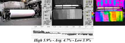

When conducting an infrared survey of a paper machine looking for moisture irregularities, I begin by looking at the sheet being wound at the reel and follow the sheet to the wet end. The following sequence of photographs, show how the cool (wet) area can be followed down the machine to determine its source. Figure 1 show a real time photograph of the sheet being wound at the reel, infrared photographs (in color and black & white) of the reel, and a copy of the mill's moisture scan of the reel. The infrared photographs correlate quite well with the poor moisture profile.

Figure 1
