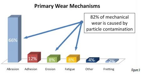

A more narrowly focused study was performed at the National Research Council of Canada in conjunction with the Society of Tribologists and Lubrication Engineers to determine the predominant wear mechanisms in wear-related failures of lubricated machinery. The study examined 3,722 failures across several industries, including pulp and paper, mining, forestry, transportation, and power generation. The results of this study indicate that the number-one cause of machine wear is lubricant contamination. (Figure 3)
Abrasion, erosion, and fatigue are most often caused by particle contamination in the lubricant. Adhesion is typically caused by using a lubricant with inadequate film strength. Furthermore, all of these wear mechanisms are exacerbated by the presence of water contamination in a lubricant. The point of all this is that most failures in lubricated equipment, whether catastrophic and sudden or just premature re-placements, are caused by particle contamination, moisture contamination, or using a lubricant that is either incorrect for the application or has degraded beyond the point of being suitable for use. The good news is that all of these conditions can be prevented or at least controlled with precision lubrication.
