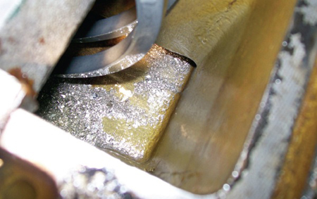

The outboard bearing was opened for inspection. Figure 2 shows the amount of babbitt located in the bottom of the bearing reservoir.
fig 2
Figure 2: Babbitt in bearing reservoir
Since this motor has a circulation/filtration system on it, the bearing reservoirs have a weir in them about three inches above the bottom to maintain proper oil level. This weir prevented most of the babbitt from leaving the reservoir and circulating in the system. Figure 3 shows the as-found condition of the bottom bearing half.
