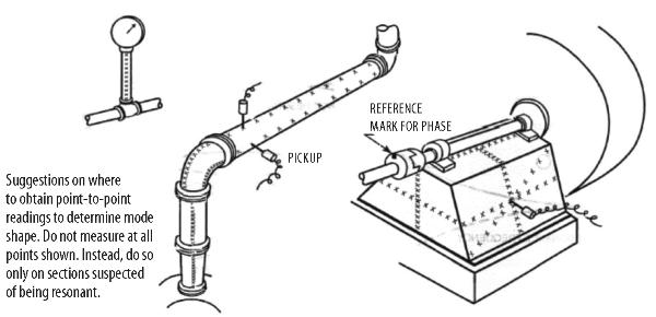

Note that the antinode portion with the largest amplitude in the “curl” shape is not where the metal cracks. Instead, see Figure 2 showing the resonance mode shape of a part when vibrating at its second resonance frequency (or a higher resonance frequency).
Part1Part1
Figure 2: Typical locations for obtaining amplitudes for plotting resonance mode shapes
Note that the location of the smallest or almost zero amplitude is called the node. At one side of the node, the metal at the top surface is momentarily in tension. The bottom is in compression. At only a one-half vibration cycle later, the situation reverses. The surface that was in tension is now in compression. The surface in compression reverses to go into tension. Back and forth at the frequency of the vibration caused the resonance modal shape.
