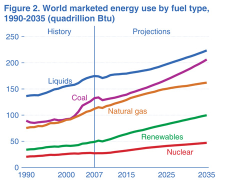

The IEO2010 Reference case projects increased world consumption of marketed energy from all fuel sources over the 2007-2035 projection period (Figure 2). Fossil fuels (liquid fuels and other petroleum,2 natural gas, and coal) are expected to continue supplying much of the energy used worldwide. Although liquid fuels remain the largest source of energy, the liquids share of worldmarketed energy consumption falls from 35 percent in 2007 to 30 percent in 2035, as projected high world oil prices lead many energy users to switch away from liquid fuels when feasible. In the Reference case, the use of liquids grows modestly or declines in all end-use sectors except transportation, where in the absence of significant technological advances liquids continue to provide much of the energy consumed.
