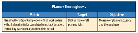

Before reviewing specific metrics, it should be noted that variations to the following metrics could be defined or utilized based on your requirements. The listing is not intended to be comprehensive, but to provide insight on specific behaviors related to maintenance planning and scheduling. Let's begin with those metrics directly influenced by the maintenance planning and scheduling function. See the following tables:
tabletable
tabletable
