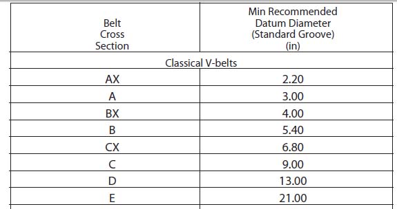

  • Sub-minimal diameter (see chart at top)

  • When the belts are stored, they must not be bent to diameters smaller than the minimum recommended sheave diameter for that cross section. (see chart above)

  • Sub-minimal diameter (see chart above)
