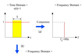

Fast Fourier Transform (FFT) is modern technology applying Jean Baptiste Fourier's (1768-1830 AD) formula into electronic format displaying time wave form data into frequency spectra.
This really makes time wave form data from machinery vibrations meaningful and somewhat easy to interpret.
