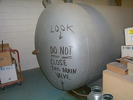

Engineers have also misunderstood the inefficiency and cost associated with compressed air. Some common wasteful and costly practices in many plants are using compressed air to blow on and cool bearings or to continuously blow on conveyors to clean them. We have seen drain valves left open with big warnings placed on the tanks above stating: "do not close this valve, keep it open".
