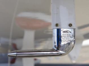

The aircraft crashed after temporary inconsistencies between the airspeed measurements—likely due to the aircraft’s Pitot tubes (shown on the right)being obstructed by ice crystals—caused the autopilot to disconnect, after which the crew reacted incorrectly and ultimately led the aircraft to an aerodynamic stall from which they did not recover.

The crash occured from Rio de Janeiro to Paris offshore near Brazil on June 1, 2009, following a flight through a thunderstorm at an altitude of ~30,000 feet under autopilot control, which breaks a practical flight commandment: “Thou shall not fly through strong thunderstorms unless the enemy is on your tail and both you and your aircraft can sustain ±9 g’s of loading.” Inside the thunderstorm, the Pitot tubes, which sense airspeed, froze from the storm’s moisture intensity. With apparent stall conditions sensed by the airspeed instrumentation, the autopilot disconnected, putting aircraft control directly in the hands of the pilots of the Airbus A330.

  • Temporary inconsistency between airspeed measurements, likely following the obstruction of the Pitot probes by ice crystals that, in particular, caused the autopilot disconnection and the reconfiguration to alternate law [special mandatory operating rules for the Airbus].
