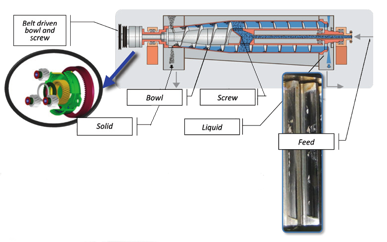

The centrifuge decanter is essential equipment to the production of ethanol. It is used to separate solid residue from whole stillage. Given the volume of product that needs to be separated, the centrifuge only can be stopped for a short period of time. For this reason, it was decided during commissioning of the Greenfield Ethanol plant in Quebec, Canada, to maximize the use of predictive technology with vibration, oil analysis and ultrasound as part of a preventative maintenance plan on these machines. To optimize the quality of the vibration signal, a triaxial accelerometer was installed directly on the gear drive torque arm to collect the gearbox signature. The predictive technician thoroughly researched the particular design of these machines to come up with all failure frequencies. Good care was also given to oil sampling, but since the gear drive is rotating with the bowl, collection time after shutdown is critical before particles settle out.
FIRST SIGN OF DEGRADATION
Two years after commissioning, vibration trends started to rise. The vibration technician identified the problem from the second reduction of the planetary gear train. With good historical data in hand and no degradation sign from the oil analysis, time was taken to order a new drive and repairs were made during a planned shutdown. The centrifuge was back to the normal vibration value and everybody (expect the leprechaun) was happy with the result of the maintenance process. To be proactive, the maintenance manager had his personnel repair the defective gearbox. This allows the vibration technician to confirm his diagnosis.
The first discovery was one planet on the secondary gear train had a broken tooth. This explained the higher value of gear mesh and confirmed the predictive technician’s diagnosis. But maintenance personnel found a defect that was not foreseen: a Leprechaun! Not a real leprechaun, but a hidden failure that was showing no dynamic sign of degradation.
The last reduction sun was missing metal flake on the loading zone. This had to be further investigated because the gear mesh of the third reduction did not show much vibration energy, making it almost impossible to detect. Root cause analysis was performed to identify causes and solutions.
Part2Part2
Figure 1: General design
