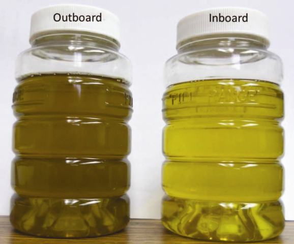

When oil samples were pulled from the inboard and outboard bearing cavities, the outboard sample was not emulsified, but it was not bright and clear like the inboard sample (see Figure 2).

One of the positive advantages of industrial oils is their ability to demulsify water. Since this reservoir is not aggressively circulated to emulsify the oil, a small volume of free water above the saturation point will separate under normal running conditions. The outboard reservoir drain valve was opened, which yielded about two tablespoons of free water before pure oil started flowing out. The original design of these motors had a drain plug directly in the bottom of the bearing reservoir. During the years before condition-based oil changes were implemented, the drain plug was replaced with a section of pipe, a valve and a cap or plug. This made yearly oil changes much easier and less messy than the previous plug removal. Currently, this set up serves as a low leg for water coming out of the reservoir area to collect in (see Figure 3).

Neither sample crackle tested positive in-house or at the lab. A Karl Fischer water test was requested even when crackle was negative to see what the water ppm was in the samples. The inboard tested at 25.3 ppm and the outboard at 32.3 ppm. Since the inboard bearing reservoir did not have visible condensation in the sight glass or free water from the drain when it was checked as the outboard did, this illustrates the close range of saturation to free water in this oil type. Another interesting note is once the free water had been drained from the outboard bearing reservoir, the condensation in the slinger ring sight glass was gone by the next day.
