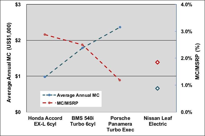

As an example, let’s examine a single class of transportation equipment: automobiles. In order to have significantly different asset values, let’s consider automobiles in three different categories: standard, luxury and ultra-luxury. Figure 1 shows the MC/AV for three such vehicles computed with data collected from Edmunds.com. 5 While MC does increase with the car’s manufacturer’s suggested retail price (MSRP)—most likely due to higher costs of replacement parts for the more luxurious vehicles produced at lower volume—MC/AV actually decreases as MSRP increases. Therefore, the maintenance team of a fleet of luxury vehicles cannot claim to be better performers than other teams that maintain standard vehicles. Hopefully, you are not rushing out to buy ultra-luxury cars because of their lower MC/AV!
Figure 1: Average annual MC and ratio of MC to respective MSRP for three gasoline-fueled automobiles of different brands and models and an electric vehicle; MC was obtained by averaging the sum of maintenance and repair costs for the first 5 years after acquisition (Data collected from Edmunds.com)
To make the automobile example more interesting, a purely electric vehicle was added to Figure 1. The annual MC of this vehicle is obviously lower than those with an internal combustion engine. Furthermore, its MC/AV is also lower than the others, except for the ultra-luxury car, although this ratio is likely to increase with future reductions of battery cost and, thus, MSRP. The lesson here is that it is not enough to consider AV; MC is also significantly impacted by technology evolution. This has been most evident in the last half century with the transition of vacuum tubes to transistors, integrated circuits and microprocessors.
