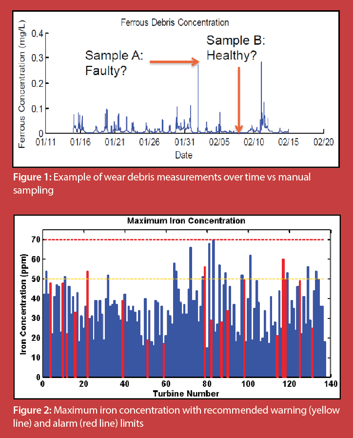

Oil quality and wear debris are typically not static, consistent, or slow changing within assets. Changes typically revolve around events, especially when transitioning from healthy to non-healthy states. Wear debris is lost in bursts over a period of time and is quickly filtered out by the filtration system. Whether or not the fault is detected, depends on when a sample is taken (see Figure 1). Contamination events or changes in oil properties, such as water contamination or additive dropouts, also occur in time periods much shorter than standard oil sampling frequencies. This often results in undetected fault conditions, causing further damage that, in many cases, cannot be reversed and may lead to catastrophic failure.

Wear debris is one of the best indicators of asset health. A study commissioned on a fleet of 137 industrial gearboxes examined the previous two to four years of oil samples, along with fault history. Figure 2 summarizes the findings with iron concentrations color coded by known healthy (in blue) and faulty (in red) gearboxes. Using traditional approaches, one would expect to find higher iron concentrations within faulty gearboxes. However, the study showed a lack of utility from these samples for determining asset health.
