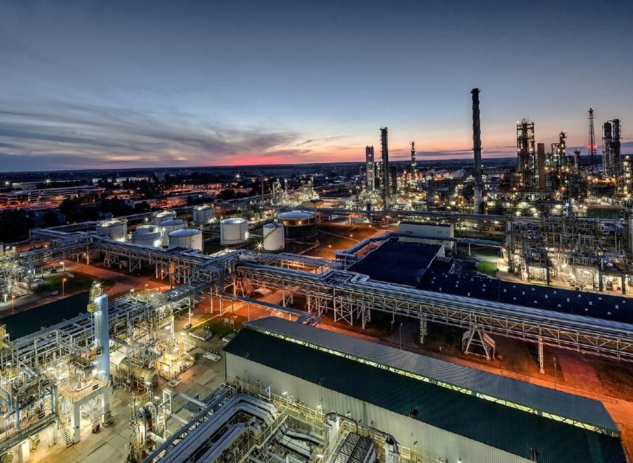

Figure 1: PKN ORLEN\u2019s production plant in Plock, Poland
Figure 1: PKN ORLEN’s production plant in Plock, Poland
