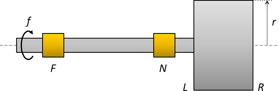

Figure 1 shows a drawing of an overhung rigid rotor, as a shaft supported on the near bearing N close to the rotor and on the far bearing F far from the rotor. It is rotating in a clockwise direction as seen from the right side with an operating speed f, with a disk of radius r to attach trial and correction weights in the left balancing plane L and in the right balancing plane R.
Figure 1: Overhung rigid rotor
