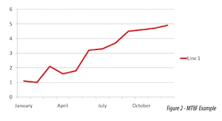

Think about Rick Mullen’s statement and its relation to Figure 1.

  • Mean Time Between Failure (MTBF) of critical assets
