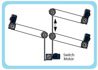

the latter. In some instances, this did create some exceptions. For example, a vertical sorter unit (see Figure 2) was taken as a single asset, even though it clearly contains three individual conveyors. In another instance, a
pneumatic conveyor extender at fire breaks was taken as a discrete subasset of a conveyor in order to simplify the development of the maintenance strategies.
back_2
Figure 2 - Illustration of a vertical switch conveyor.
