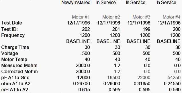

Capacitance-to-Ground Case Study #1:– What’s wrong according to the data in Figure 8-22? It would appear that Motors #2, #3 and #4 are grounded and may be contaminated as well with something providing a path to ground over their insulation systems. It is also possible that the Capacitance-to ground (CTG) reading may be affected by cable length if the motors are at progressively greater distance from the motor control center where the readings were taken.
Figure 8-22 - MCrA Tests of 4 Identical Motors
