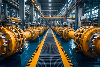

A large chemical plant in Brazil faced persistent gasket failures in a key heat exchanger, leading to daily maintenance interruptions. With high operating temperatures and pressures in heat exchangers, even minor leaks can result in decreased efficiency and create safety hazards.
Gaskets play a crucial role in compensating for flange surface irregularities, preventing process fluid escape, and maintaining thermal and mechanical stability. Without a reliable gasket, fluctuating operating conditions can cause joint relaxation, leading to leaks and potential equipment failure.
In this case, the plant used skived virgin polytetrafluoroethylene (PTFE) gaskets, which proved to be inadequate for the challenging application. The gaskets suffered frequent failures, resulting in at least two hours of unplanned maintenance downtime per day. These costly recurring issues significantly impacted overall plant efficiency, prompting the facility to seek a more effective sealing solution.
Example of a heat exchanger used at a chemical plant.
