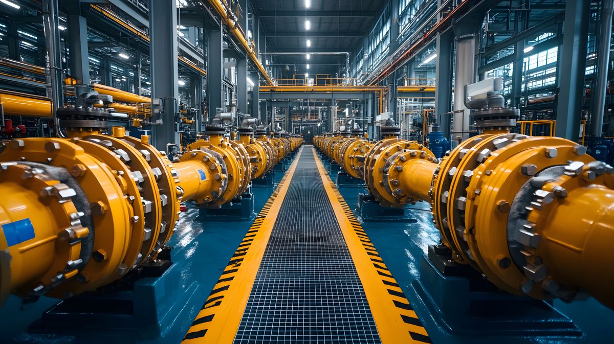

Example of a heat exchanger used at a chemical plant.
