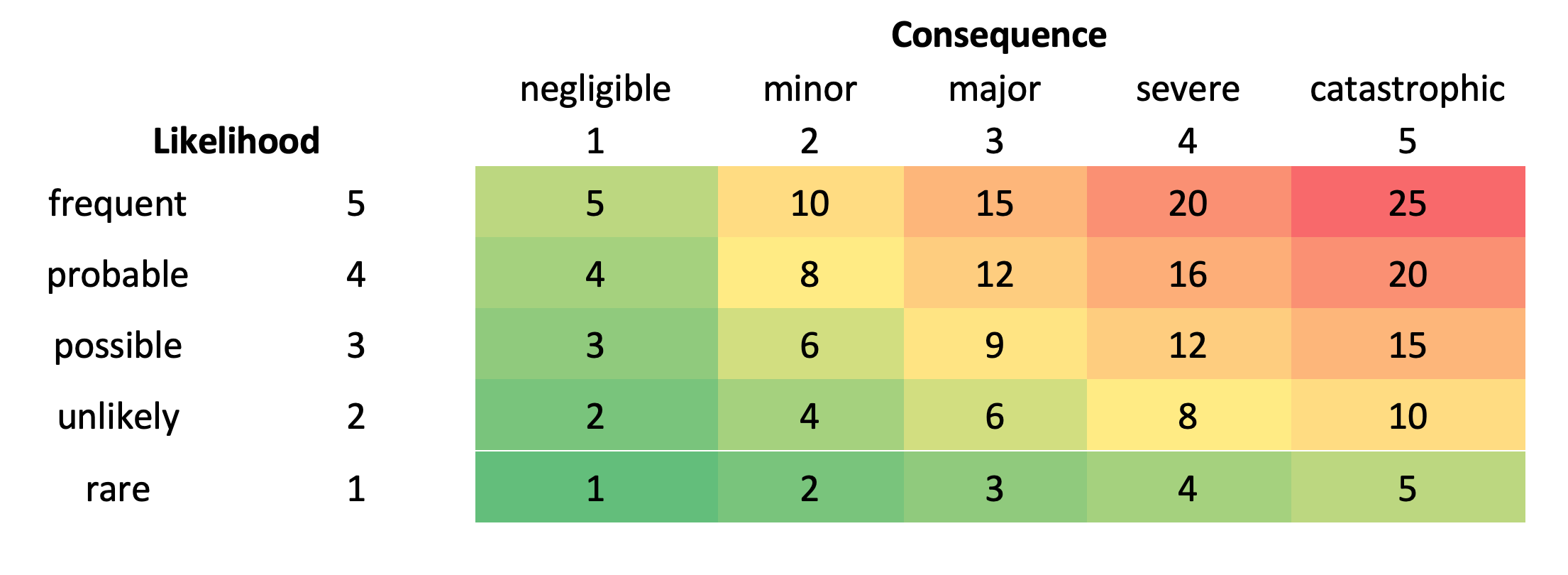

Merriam-Webster's Dictionary defines risk as the “possibility of loss or injury.” The International Organization for Standardization’s ISO31000 defines a risk matrix as “a tool for ranking and displaying risks by defining ranges of consequences and likelihood.” With these two definitions, you can simply define a risk matrix like the example in Figure 1.
Figure 1: Risk matrix example
The problem with this simple approach is context. Can it really be said with confidence that a rare but catastrophic event is as low a risk as a negligible but frequent event? No, because the matrix in Figure 1 lacks meaningful context. Experience shows that different risk contexts require different risk visualizations.

On the other hand, the risk matrix is a very good tool. It provides a visual representation to communicate risk concepts simply while providing a framework for prioritization. It can be customized for specific organizations with specific definitions of risk. It is no wonder industry so quickly wants to adopt it to understand risk across organizations. Unfortunately, a risk matrix is not a good tool for comprehensive risk quantification, nor its mitigation. It is limited to discrete ranges of probability and consequence. It is often oversimplified, subjectively qualitative and does not consider how risk changes over time.
