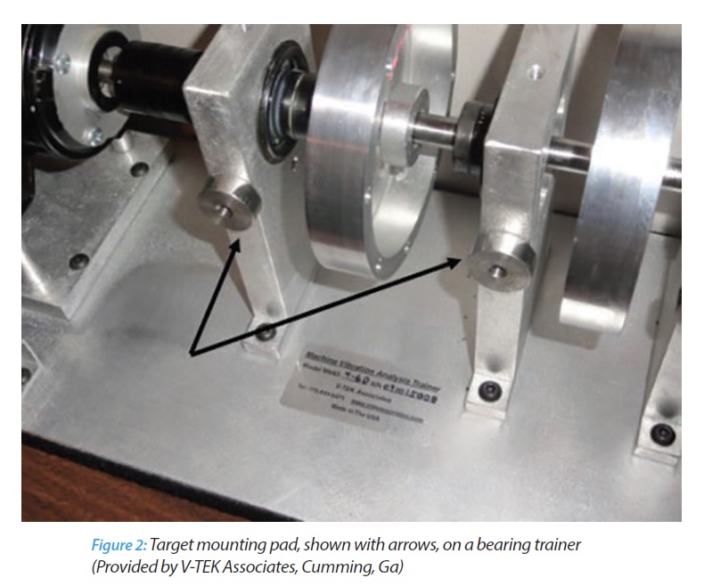

A target mounting pad, shown in Figure 2, is commonly referred to as the vibration pad that an accelerometer is placed on for data collecting. It also can be the point where an ultrasound technician comes back to from the previous data collecting reading to keep the readings consistent for comparison purposes.

Magnetic sensors, such as a two-pole magnetic sensor, are preferred by many since the two-pole magnetic base may mount on flat or rounded surfaces. Standard pick-up points need to be flat and free of dust, dirt, grease and excessive buildup of paint or coatings.
