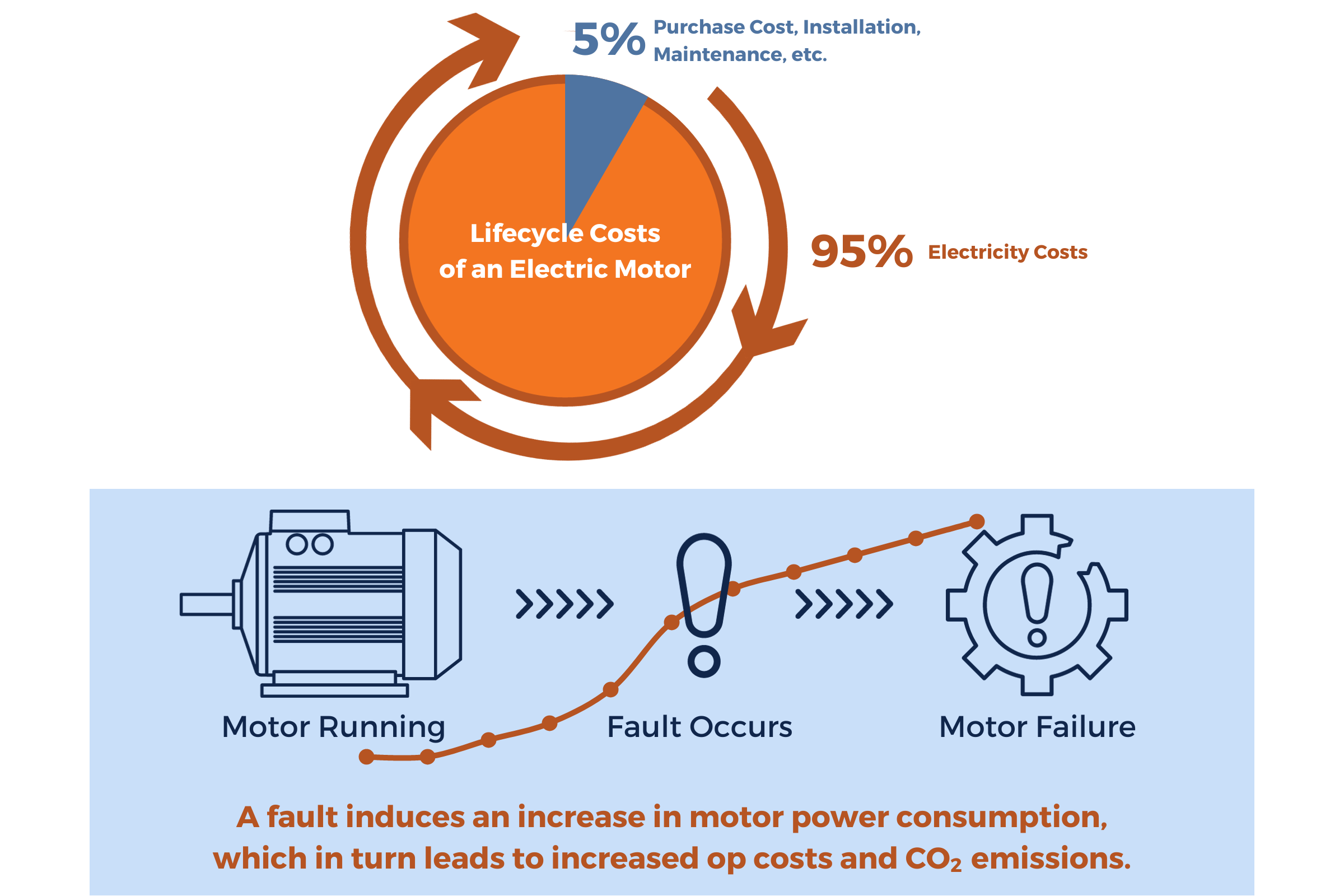

More than 90 percent of the lifecycle costs of motor-driven machinery are due to energy costs, while the cost of the motor, maintenance and installation itself are just five to seven percent of the overall lifecycle costs. Not every piece of equipment leads to downtime on an annual basis, thus downtime related return on investment (ROI) can take longer to justify. Because of this, to keep lifecycle costs of operating motor-driven machinery low, regular maintenance is required to ensure its energy consumption is as consistent or optimized as possible.
Figure 1: Lifecycle Costs of an Electric Motor - Overall costs increase when in a fault state.
