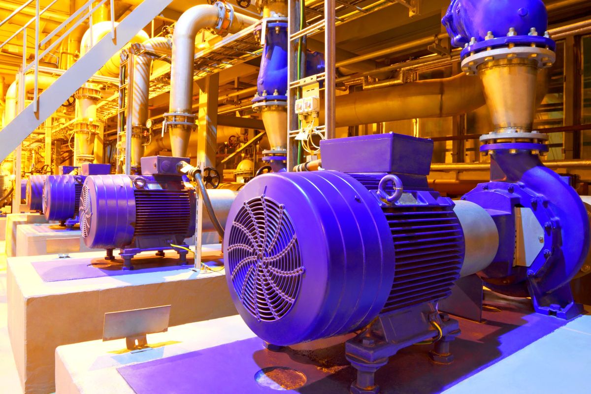

A 250 horsepower pump was running in an airport for almost two years without issues. However, as soon as the IoT-based wireless sensor was installed on the motor and pump, a peak on the vane pass frequency (VPF) in the vibration fast Fourier transform (FFT) spectrum from the pump drive end side was noticed in the first two weeks.
VPF = RPM * No. of vanes on the pump impeller
More than 60% of the global electricity consumption is due to motor-driven machinery.
Although there was an excitation at pump vane pass frequency, the overall vibration was still within reasonable limits, as shown in Figures 4 and 5.
The maintenance technician opened the pump during a normal planned maintenance window and observed that one of the vanes on the pump impeller was not constructed properly, causing a slight imbalance when the pump was running at high speed (1780 rpm). The imbalance was not high enough to show high vibration overall, but was strong enough to show a peak at vane pass frequency.
The technician did some metal work and shaved off the extra piece of metal and made all four vanes symmetrical from all sides. Coincidentally, this not only resolved the vibration at vane pass frequency due to imbalance, but also reduced the energy consumption of the pump and motor by as much as seven percent.
