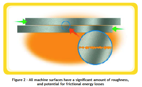

The Nature of Machine Surfaces
Machine surfaces are rough. Figure 2 illustrates typical surface profiles for all machined surfaces. Even finely prepared bearing element and race surfaces exhibit undulations. As shown in Figure 3, machined surfaces have a wavelike profile. The average of the height of the ridges, value 'r', differs based on the OEM's finish technique. Element bearing finishes will have maximum surface heights in the 0.2 micron range, and average heights in the 0.4 micron range (RMS). Ground gear finishes will have surface heights approaching three microns, and averages heights approaching 0.6 microns (RMS).
Figure 2 illustrates typical surface profiles for all machined surfacesFigure 2 illustrates typical surface profiles for all machined surfaces
Separating Machine Surfaces
The dynamic oil film thickness must always be greater than the heights of the combined surfaces in order to avoid frictional energy losses. The ideal condition would be an oil film that is three to five times thicker than the height of the combined surfaces. Component suppliers provide formulas and standardized tools that are useful in establishing minimum viscosity operating requirements. Reputable suppliers provide engineering support to their customers to help refine lubricant selections, and for most applications, the first run selections are not difficult.
Inadequate film conditions occur as a consequence of changes in load, changes in machine operating temperatures, changes in lubricant condition (particularly contamination with gases or fluids), and accidents in lubricant handling and application, which lead to viscosity errors. These condition changes often occur simultaneously, resulting in film collapse, machine component interaction and greatly increased frictional resistance.
