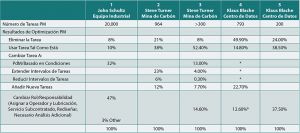

Table 1 compares the outcome of five PM optimization efforts from different industries. The first study is based on industrial equipment, the next two studies are from mines and the final two are from two different data centers.
Table 1 - Comparison of Five PM Optimization Studies
Sources
  1. Moore, Ron. Selecting the Right Manufacturing Improvement Tools: What Tool? When? Fort Myers: Reliabilityweb.com, 2011, p. 251.
  2. Turner, Steve. “PM Optimization Case Studies at Two Coal Mines.” ReliabilityWeb.com download
  3. Ibid
  4. Blache, Klaus. “Data Center PM Optimization Study, 2014.”
  5. Blache, Klaus. “Data Center PM Optimization Study, 2015.”
  6. 12.60 percent also includes items marked with*.
The infrastructure of data centers (e.g., pumps, fans, cooling tower, transformers, compressors, air handlers, fire protection, filters, power supply, etc.) is just as ripe for improvements as most other industries. There may be some facilities that would not benefit much from PM optimization, but those have not been found as yet.
Although the data findings were collected in varying categories, the studies have been compiled to enable some comparisons. The reasons for the differences are the age of the equipment (e.g., just being commissioned versus being in use for a long time), type of industry, team member backgrounds and level of experience, focus of the optimization initiatives and so on. All these factors guided the failure modes, strategy discussions and decisions.
As the data findings show, PM optimization is a useful tool in all types of industries, such as manufacturing, process, mining, utilities and yes, even data centers.
