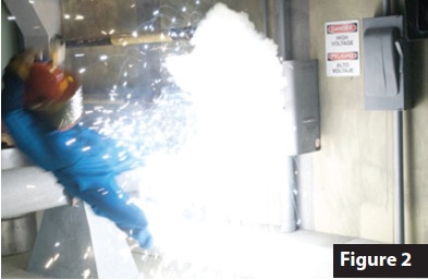

Figure 1, is based on the designed functionality of circuit protective devices. If these devices do not function as designed, the thermal and blast energy exposure may be orders of magnitude greater than expected. The photograph in Figure 2 illustrates an arc flash event in progress. The arc flash hazard analysis and the selection of PPE are dependent on the protective devices to function as designed. In other words, the maintenance of certain devices and systems are critical to the safety of personnel who interact with the electric power equipment. Circuit breakers must function as new. Overcurrent devices must operate at the designed and documented pick up and time settings. If circuit breakers or protective devices are dependent on an external power supply, the tripping power system (usually batteries and battery charger) must function as designed. If the protective device is a fuse, it must meet the design specifications and be the type, class and rating of the one documented in the arc flash analysis.

Fig 2
Figure 2 - An arc flash event in progress
