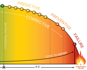

Think about all the initiator causes of failure that are not really related to maintenance. Initiator causes are those events, possibly microscopic, that initiate decay shown by the P-F curve. Examples of initiator causes might include heat, dirt, or overloading.
Figure 1 shows a P-F curve, with the arrow pointing to a potential failure that is precipitated by some initiator. This initiator can be microscopic, such as a piece of dirt, or macro, like a steel slab hitting the rollers off-center. Once the potential failure is realized or initiated, the march to destruction is inevitable. The only unknown is how long it will take. At this point, the only thing of interest is how soon the march to destruction can be detected.
![Potential failure shown on a P-F curve.](https://assets.rebelmouse.io/eyJ0eXAiOiJKV1QiLCJhbGciOiJIUzI1NiJ9.eyJleHBpcmVzX2F0IjoxNzIxMTc5ODU1LCJpbWFnZSI6Imh0dHBzOi8vYXNzZXRzLnJibC5tcy8yOTgxMTU0Ni9vcmlnaW4ucG5nIn0.W9xEk7c6Boi4VN3QnFDPXkQ-z8i_7vF4WIq3sLBLlnQ/img.png)
