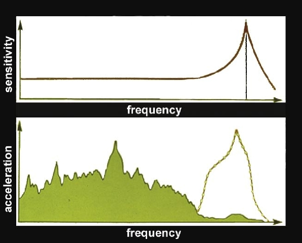

Figure 2 shows that they all resonate at some natural frequency (fn) and they all over report vibrations around fn. Don’t try to use them above 0.1fn or 0.2fn.
part2part2
Figure 2: Effect of a too low accelerometer fn
