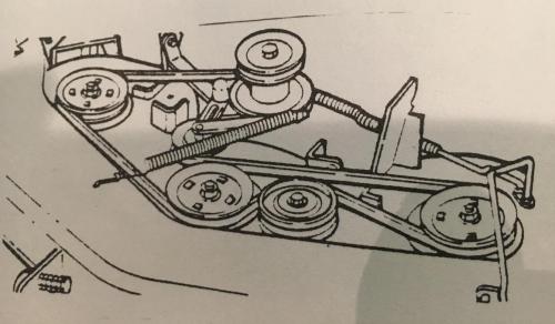

As a typical example, consider this real-life lawn mower situation. A lawn mower is basically run to failure, with the exception of some basic preventive maintenance (PM) measures, such as lubrication (e.g., grease and oil change), sharpening blades, etc. But in this situation, the drive sheave assembly bearing failed. It is a one piece sealed bearing (i.e., lubed for life), as shown in Figure 2. Since it is necessary to disconnect the deck and roll it out from the mower to change this assembly, should other components being changed as well? The entire drive sheave assembly costs around $300 (which is the original dealer’s selling price), while bearings cost only $24. Since the mower was partially torn down, changing the blade bearings was considered. They are only sold as assemblies and cost $150 each, so $450 total. Of course, this investment needs consideration. The mower is 25 years old and is serviced on a regular basis by greasing the bearings. Although it still runs and works great, spending $450 to replace blade bearing assemblies and $300 to replace the drive bearing sheave assembly could not be justified due to its age. Since the sheave itself was in good shape, new bearings were purchased for $24. The belts were also inspected and they were in good shape. So, with free labor, the mower was fixed for $24 versus $750 for a partial overhaul. If all new belts, blades, springs, etc., were added, well over $1,200 would have been put into a 25-year-old mower.

The decisions about the scope of what to replace should be vetted since there are many factors to consider and rarely does a one-size-fits-all approach apply. A reliability organization adds value in these decisions by taking known information about the equipment so an educated decision with calculated risk can match the business model. This information comes from various sources, such as vibration analysis, oil analysis, infrared, preventive maintenance, failure history, past root cause failure analyses (RCFAs), etc. Criticality of equipment is also an important factor in risk evaluation.
