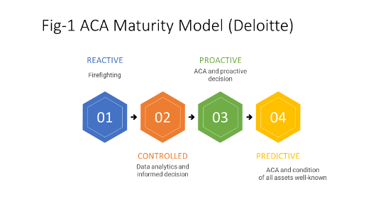

The current state of an organization’s asset management can be categorizedinto four stages (Fig-1) (Deloitte-CEA):
  1. Reactive stage: The organization is in firefighting mode. They areoverwhelmed by failures and breakdowns.
  2. Controlled stage: Operations, maintenance, and QAQC data are collectedand analysed for informed decision-making.
  3. Proactive stage: The organization has a robust asset conditionassessment system. They are using data to make proactive decisions.
  4. Predictive stage: This is the ultimate situation where the conditions of allassets are well-known, and the organization uses asset conditionassessment data and analytics to predict and prevent issues before they occur.
The asset condition assessment journey (Fig-2) can be adapted to suit theorganization’s needs and requirements.
