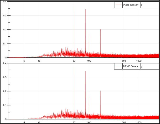

Figure 2 shows resulting frequency spectrum measured for the MEMS accelerometer with 21 kHz resonant frequency and the PZT sensor with 25 kHz resonance. The root mean square (RMS) output of the MEMS accelerometer in the band from 1 Hz to 1 kHz is higher than the PZT accelerometer by approximately 30 mg, or 1.7 percent.
Figure 2: Noise density spectrum for PZT accelerometer (top) and MEMS accelerometer (bottom); results are nearly identical up to 10 kHz, with a key difference in the low frequency response of the MEMS accelerometer
