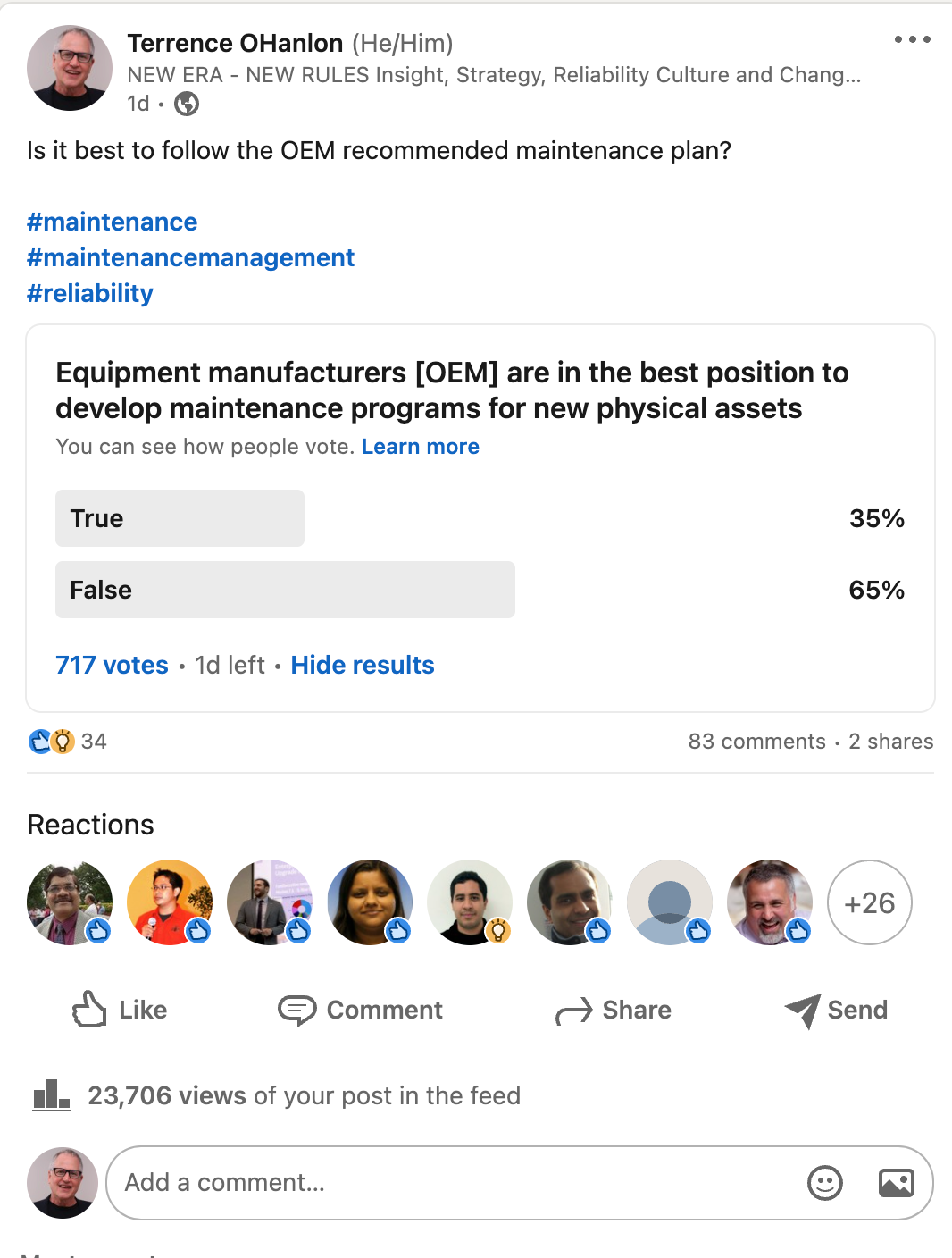

Is it best to follow OEM recommended maintenance plans?
OEM recommended maintenance plansOEM recommended maintenance plans
One of my favorite activities at LinkedIn, is inviting reliability leaders from around the world to stand in enquiry around some of the tricky, multidimensional challenges we face on a day-to-day basis.
There are powerful insights for each of us in this featured discussion around following the maintenance recommendations of the original equipment manufacture [OEM].
The discussion ranged from outright "No" to "If you don't you will go to jail".
Do not expect simple outcomes from this cohort of global reliability knowledge and experience, however; it my hope is that you experience breakthroughs for your reliability journey. Do not worry about what the crowd thinks. Stand on your own two feet and think for yourself like a reliability leader does to get the most from this post.
Here is the original post that started this 360 enquiry on following OEM Maintenance recommendations.
Is it best to follow the OEM recommended maintenance plan?

"Had to vote to see the results and dismayed to see that > 30% of people who voted think that OEMs are in the best position to develop maintenance plans for their equipment. We clearly have a long way to go as a maintenance community... sure OEMs have a role to play. Most OEMs will know their equipment well and understand dominant failure modes but very often they will not know the consequence of failure of their equipment in your plant and therefore for most equipment OEM recommendations should only be seen as guidance. I have seen excellent maintenance plans from top OEMs who are deeply involved in supporting and servicing their equipment around the world and therefore understand failure modes, consequence etc. But I have seen more bad OEM maintenance plans than good ones. Ultimately, we as equipment owners are in the best position to create our maintenance plans, we should understand our equipment and the consequences of failure." - Erik H
