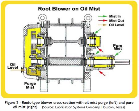

Next, the engineer asked for a case history that we might comment on. Well, we know the oil mist provider has access to such case histories and would be pleased to share them with any prospective client. The general configuration of Roots-type positive displacement blowers is depicted in Figure 2; it highlights where and how both pure mist and dry sump oil mist are applied on the same blower. Unfortunately, users are often reluctant to share their success stories with the public and we may have to depend on others to do the explaining. The bearings on the gear side are splash lubricated from the action of the oilcontacting gears. The space above the liquid oil is not vented. Venting would lead to mist flow and would cause more mist to coalesce (become reclassified into liquid oil) and the oil level would rise. By not venting the gear side, one avoids adding to environmental pollution and avoids having to actually remove oil from the sump. Dry sump (pure) oil mist lubrication is used on the input side of the blower.

Dry sump oil mist (properly applied) is a real attractive lubrication method for rolling element bearings in virtually all industries. Only oil jet lubrication (a superior form of forced lube) is technically better. However, oil jet lube would be more expensive and probably difficult to cost-justify for the positive displacement blowers at issue here.
In short, it is well known that many Roots-type blowers are lubricated by oil mist. However, first and foremost, the dry sump ("pure") oil mist is intended for rolling element (erroneously called "anti-friction") bearings and not, in the case of these blowers, for sleeve (or "plain") bearings or gears. Dry film lubrication development is strictly a function of oil type and temperature. For Roots-type blow-ers, dry film lube sounds like a research project with lots of variables. And so, we would stay clear of that, for now.
The oil mist must be ported through the bearings at the input side of the blowers. Except for "bearings only" regions where dry sump oil mist greatly excels over purge mist, wet sump (purge mist) will help considerably by preventing contaminant entry into the bearing and gear housing. Thus, purge mist should be used on the gear side of the illustration in Figure 2, but the mist routing may not be the same on different physical layouts or other housing configurations.
Of critical importance to dry sump oil mist lubrication is the mist entry point. If applied per API-610 (8th through 10th Edition), oil mist will protect bearings better than anything short of an oil jet impinging on the rolling elements. While oil mist may still work even if not applied per latest API-610 recommendations, a facility that disregards these straightforward recommendations loses its claims to be reliability-focused.
When utilizing an appropriate synthetic oil (mist) for both bearings and gears, the maximum allowable temperature is usually set by the bearing metal and bearing-internal clearance considerations (230ºF), and not by the lubricant temperature. The temperature permitted by several available high performance synthetic lubricants certainly exceeds 300ºF.
