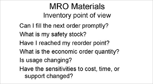

Figure 1-2 MRO Materials—Maintenance
Figure 1-3 MRO Materials—Inventory
Figure 1-3 highlights the inventory point of view for MRO materials. As can be seen, the MRO organization is interested in providing good service to the maintenance organization. The MRO organization focuses on using good inventory controls to accomplish this goal. So the MRO organization is concerned about their safety stock, the reorder point, the economic order quantity, and usage patterns. The MRO organization will also need good, complete data to track the proper costs, delivery times, and levels of support that are necessary, always focusing on the lowest overall cost.
