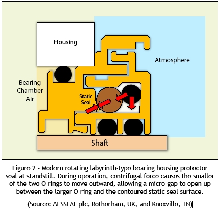

Over the years, pump users and manufacturers have collectively estimated that 33% of all pump failures are due to bearing distress. Incorporating feedback from many pump users, bearing manufacturers generally attribute roughly half of these failure incidents to airborne (atmospheric) debris and water vapor entering the bearing housings of process pumps2. Yet, it is widely known that contaminants can be excluded with suitably configured bearing housing seals. Modern bearing housing seals, also called bearing protector seals (Figure 2), lead to fewer failures and achieve rapid payback. This is especially true when industry research corroborates that lube oil contamination is rampant in process pumps used in the Hydrocarbon Processing Industry3.
Figure 2 - Modern Rotating Labyrinth-type bearing housing protector seal at standstill. During operation, centrifugal force causes the smaller of the two O-rings to move outward, allowing a micro-gap to open up between the larger O-ring abd contoured static seal surface. (Source: AESSEAL plc, Rotherham, UK and Knoxville, TN

It is quite reasonable to assume that the average pump shaft size employed in the Hydrocarbon Processing industry is 2.250" (60 mm). For such a pump, a modern API 610 (10th Edition-compliant) non-contacting bearing housing seal with an integral static moisture shut-off valve (Fig. 2) would cost $147.
A similar assumption places the cost of an equivalent and presently installed pump lip seal at $45 each. Therefore, the upgrade cost (incremental cost) from previously two lip seals to now two advanced rotating labyrinth seals is, on average, $204 per pump. To then upgrade eight 2.250"/60mm average shafted pumps to advanced rotating labyrinth-type bearing protector seals will cost $1,632.
Returning to our earlier points and data reviews, a mechanical seal in hydrocarbon service costs $4,000. According to the Stephen Flood study and the cost data submitted by a well-respected manufacturer of both mechanical seals and advanced bearing protector seals, the rotating labyrinth seals of Fig. 2 will pay for themselves within a 3 - 6 month period, based solely on the mechanical seal failure reduction realized.
