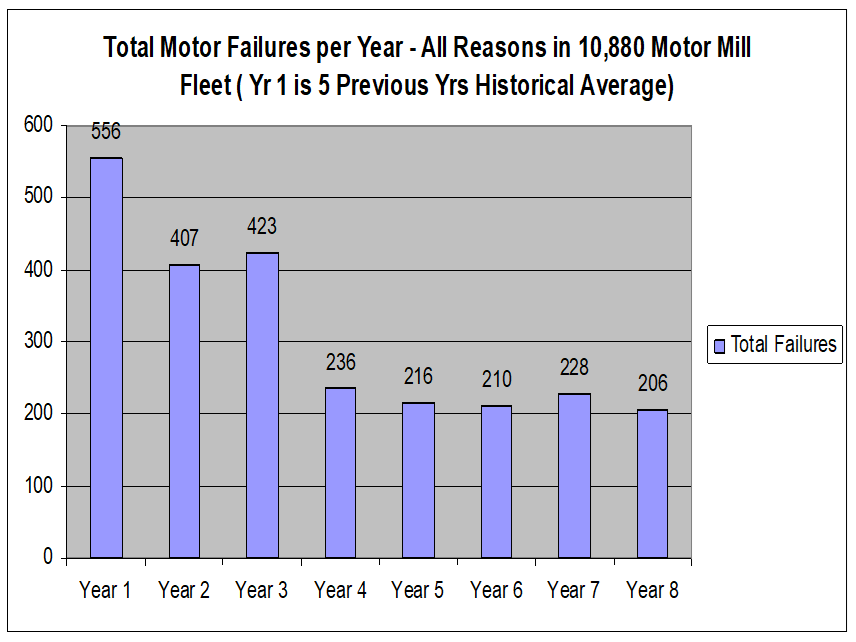

Figure 1 shows actual results obtained by implementing and insisting on precision installation and maintenance at the world’s largest pulp and paper mill.
Figure 1: Results from precision installation and maintenance
Prior to precision state, the average life of the mill’s motors was 19.6 years. Concentrating efforts on the troublesome and costly motor positions first, and insisting that the hundreds of others vibrating at higher than the newly established minimum acceptable levels be put into a “precision state,” easily more than doubled the life of the electric motors to an average life of 46.1 years, or conversely, cut the failure rate in half in just four years. Some eight years later, the rate has been sustained and now reflects an even higher average motor life of 52.8 years.
