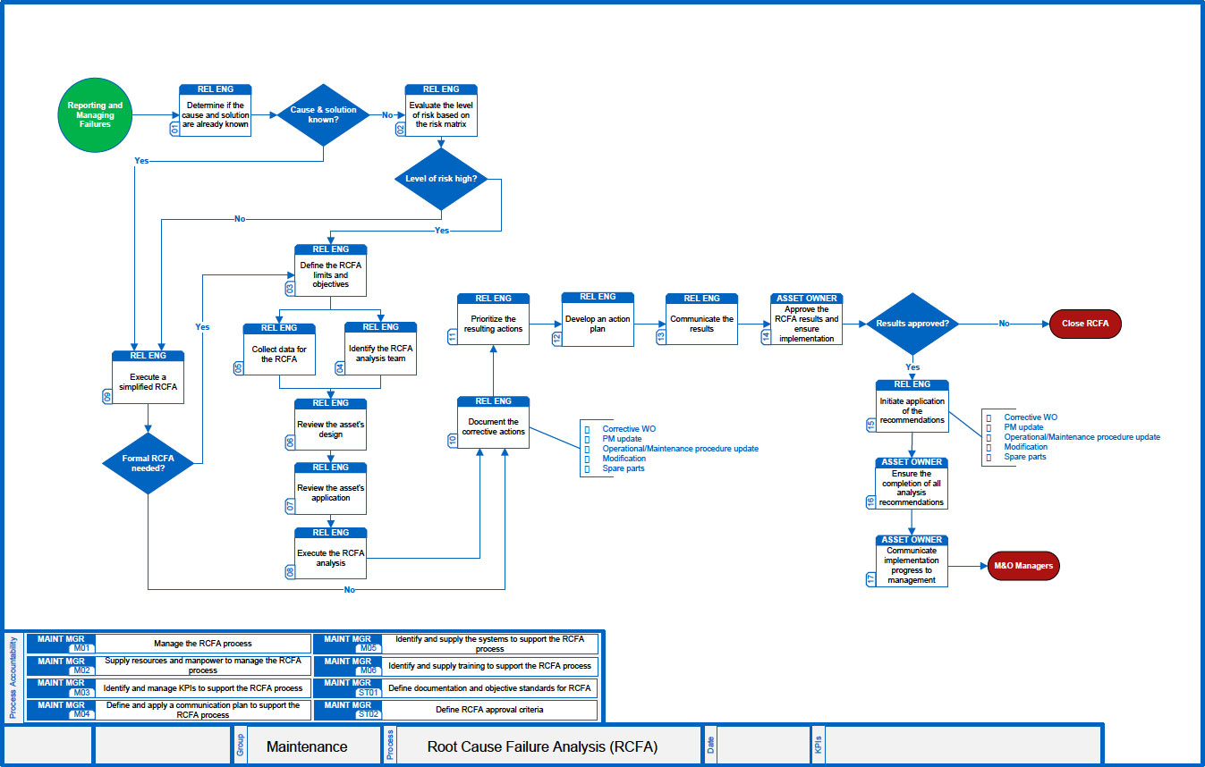

It is generally much easier to separate the business process into elements, and then to create a map for each element. Each element map is composed of tasks that represent the steps needed to properly support the element, and arrows to demonstrate their relationships. This is where we need to use judgment. How detailed we define the process will determine the usefulness of the map. A rule of thumb I like to use is that we want enough details so that the map becomes a good visual aid to do the work, but not so much detail as to render the map complex and difficult to use.
Some people use swim lanes as a way to depict who is responsible for each task. Swim lanes are typically horizontal zones where each zone represents a specific role within the organization. By looking at your lane you can easily see all tasks that are assigned to you. I like swim lanes if the maps are kept relatively simple, but on more complex maps the connecting lines are confusing. For more complex maps such as the ones discussed here, I prefer adding a header on each task to identify who is responsible for that task. The map then follows the process logically from start to finish and has sufficient details to be a useful visual aid.

The following are examples of process maps. As you will notice roles are added as headers and the maps follow the logical process steps. An important aspect of the maps is their visual value. We should always strive to document our processes and procedures and encourage/mandate our personnel to read and apply these. However, procedures tend to be wordy and cumbersome to refer to regularly. A graphical representation of the process, though not as thorough, is an excellent reinforcement tool and can easily be posted in strategic areas as a visual reminder.
Map example
Map example
