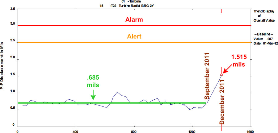

Figure 2: Condition monitoring data, turbine bearing 2
The machinery protection system was set up to alert the user of vibration levels over 2.5 mils pk-pk and be in an alarm state if amplitudes were above 3 mils pk-pk. The historical vibration data showed amplitudes at this bearing position averaging .685 mils pk-pk, with an increase to 1.515 mils pk-pk after being put back into service in December 2011.

Figure 5: Condition monitoring data, turbine bearing 2
